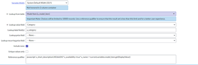

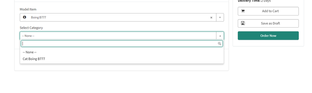

Hi @mani55 ,
I tried on PDI and its working.
You may try with the following ref qualifier :
javascript:'u_short_descriptionLIKEdsk045^u_availability=true^u_name='+current.variables.model_item.getDisplayValue()
Can you please check the backend field name of short description as everywhere you used u_field_name.
