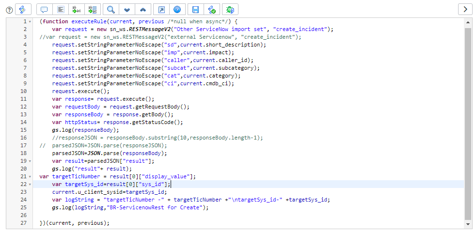

"{"error":{"message":"Invalid staging table""detail":"Specified table does not extend'sys_import_set_row'"}"status":"failure"}", The following error is populating in logs when an incident is created in source instance( I have created a Staging table extending import set row in target instance) and also i am getting the below error.
org.mozilla.javascript.EcmaError: Cannot read property "0" from undefined
Caused by error in sys_script.dc22603bdb460010fac27a61399619d8.script at line 21
18: parsedJSON=JSON.parse(responseBody);
19: var result=parsedJSON["result"];
20: gs.log("result"+ result);
==> 21: var targetTicNumber = result[0]["display_value"];
22: var targetSys_id=result[0]["sys_id"];
23: current.u_client_sysid=targetSys_id;
24: var logString = "targetTicNumber -" + targetTicNumber +"\ntargetSys_id-" +targetSys_id;( screenshot for the before insert BR is attached) and the result is showing like undefined.

01-07-2020 11:06 PM
It seems you are doing it in wrong way,
You can try on this way:
var responseBody = response.getBody();
var httpStatus = response.getStatusCode();
var obj = JSON.parse(responseBody); //define JSON parsing for the response JSON file to decode
var targetIncidentID = obj.result.sys_id;
// sys_id is key from response received , you can replace with any key in json like obj.result.number or obj.result.cmdb_ci
// obj.result.KeyNAME : will be the same for all
gs.log("HTTPCODE:"+httpStatus+"BODY"+response.getBody());

01-08-2020 01:51 AM
Thank you Abhishek for the information, it was helpful:)
