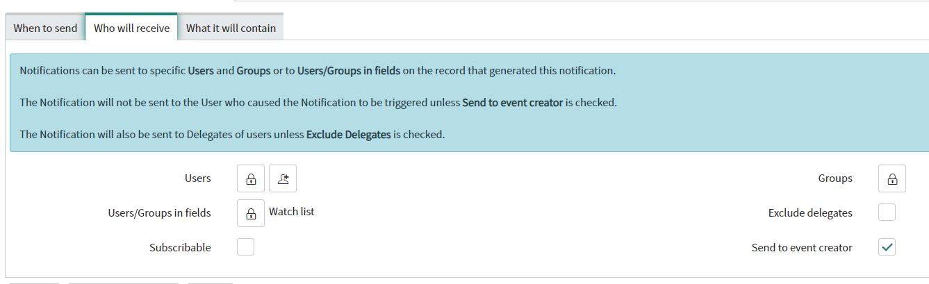

01-08-2020 02:40 AM
I already found the problem. The watch list field was empty when the notification was checked. Therefore, when trying to send the notification, "Who will receive" was empty.
Thank you so much!

01-08-2020 01:08 AM
Hi Dennis,
What are the other conditions applied on that notification?
Can you share screenshot here?
Event parm 1 contains recipient checkbox should be true
Send to event creator should be true
