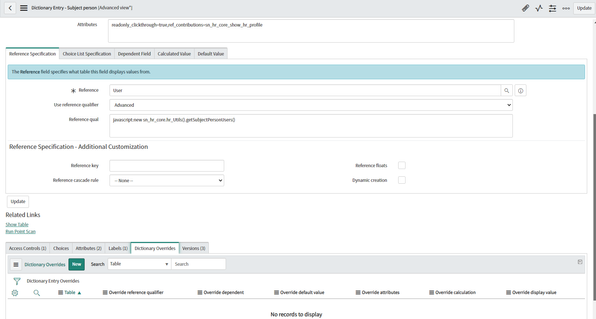

Hi @Arun_S1
I cannot find the "Enable Override Attributes" checkbox. Below is what my page looks like. Any suggestions?
