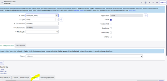

Hi @Manu143
You want to change the Label ?? right.?
You can right click on that field >> select Configure dictionary
new form will get open like below :

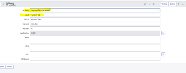

In related list click on create new entry in "Label"
Select table and Label and save the form.

Hi @Manu143 ,
No it will not affect other tables. after doing changes you can cross verify by opening record from any other child table of alm_asset.

Hi @Manu143 ,
No there is no need to create new dictionay override and label used only for this table not affect to another table.
