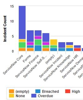

I have reports based on Incident table that do not reflect the correct colours based on Color Definition. e.g In 'Chart Colors' under Reports, the u_sla_breach_level is expected as Red if at Breached
However, in the actual reports, the presented color doesn't seem to follow the definition. e.g Breached shows as light-blue (as screenshot below)
The report settings is configured as below
If taking out the Stacked by and change the Group By 'SLA Breach Level', the colour still doesn't match the definitions.

Maybe you just need to ensure that the expected Name, Element, and Value in the Chart Colors table are correct.

Please go to the "chart colors" module under report Application and define the element and its value for which you want a particular color.Lest say ,and element is state and if its value is pending then color should be orange   .Here you can define colors for any table of your choice.

Did you configure the report to use the chart colors?
Your custom colors are only displayed, if you set Chart color to the third option.
Thanks Jochen, it worked as expected.   You are a champion!
