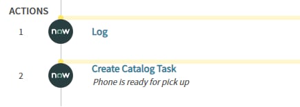

The issue is that request_approved is set outside the flow script. I've tested running two stages after eachother (request_approved and then delivered), using a log action for separation (can't run two stages next to eachother right?).
This kinda works, request approved goes to green and the list view moves on the delivered but it seems to generate a massive amount of sc tasks (10 instead of 1) - I have no idea why.
