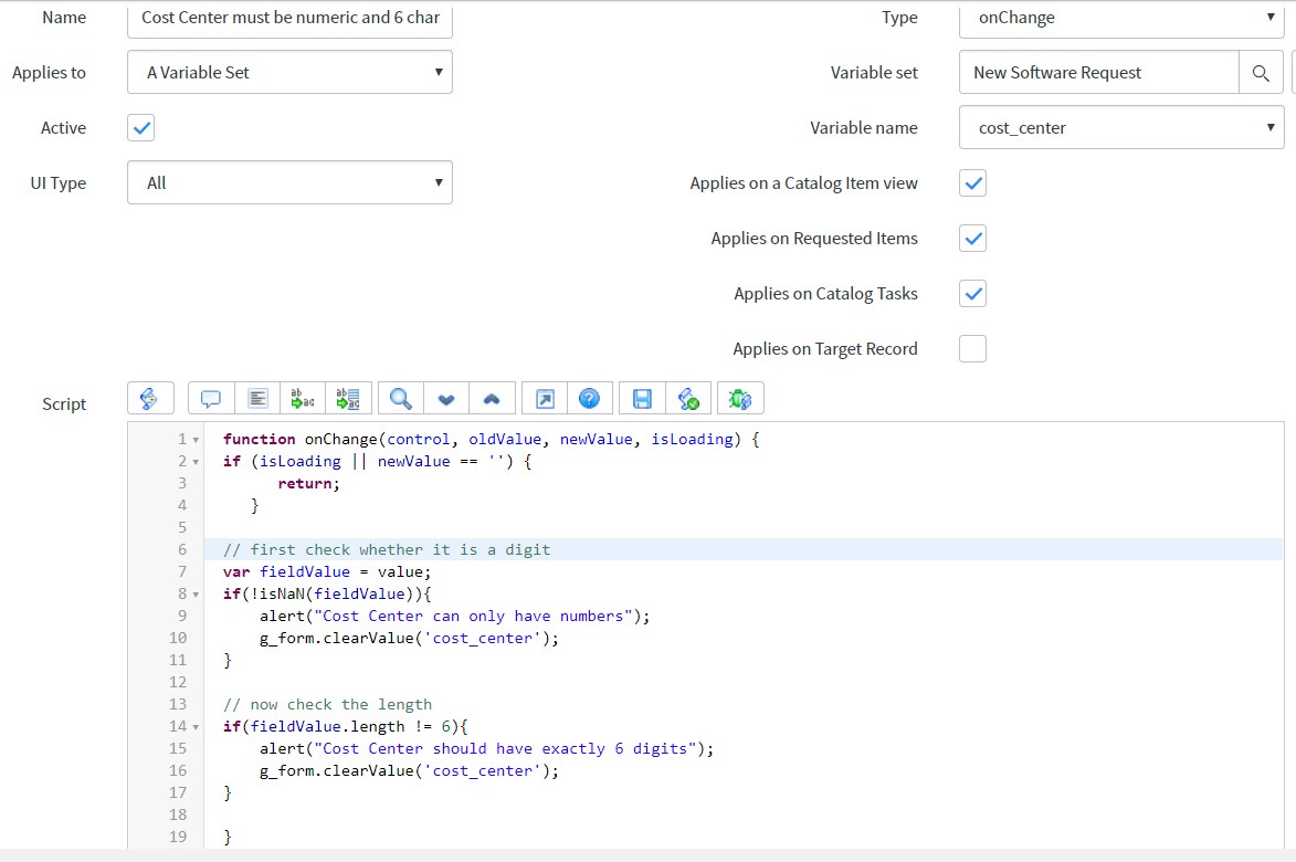

I pretty much have the same scenario. We have a Single Line Text variable on our form that MUST be exactly 6 numbers. So I tried incorporating this variable script, but cannot get it to work. I get a JavaScript error, and then it accepts any entry I make.
Here is my script:
The only difference it is running against a Variable Set, but that shouldn't matter, should it?
Here is the error message I get:
"There is a JavaScript error in your browser console", and then it accepts the entry, even though it doesn't meet the criteria.
Any idea why this isn't working?
