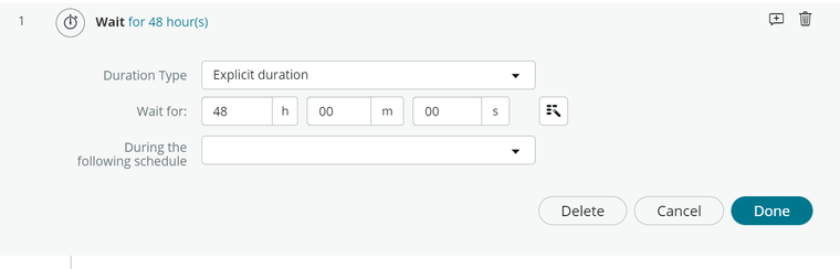

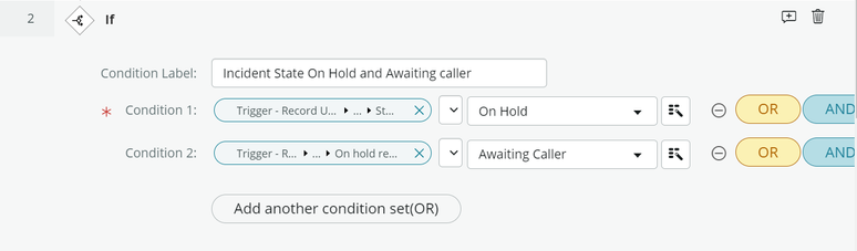

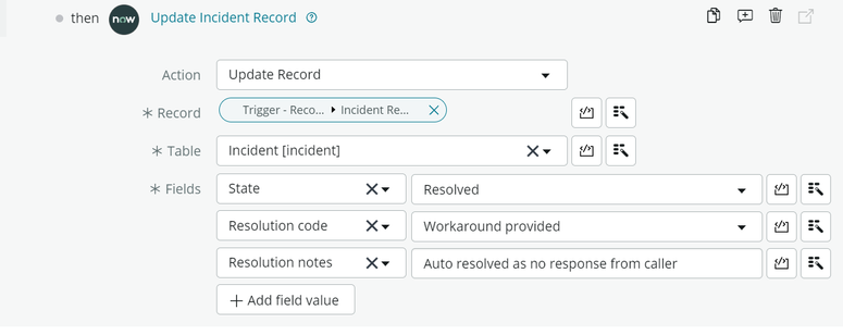

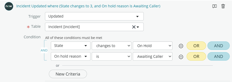

You can create a Flow designer which will trigger when Incident's State is changed to On Hold and On Hold Reason=Awaiting Caller.
Have a Flow Logic with Wait for Duration of 48 hours (2 days).
Than check if State values are same:
Then update state as 'Resolved' and field mandatory fields like Resolution Notes and Code:
Field values you can put based on your requirements.
Flow Designer are recommended by ServiceNow for any such requirements where process need to be automated.

Hi @Ankita dhavale
