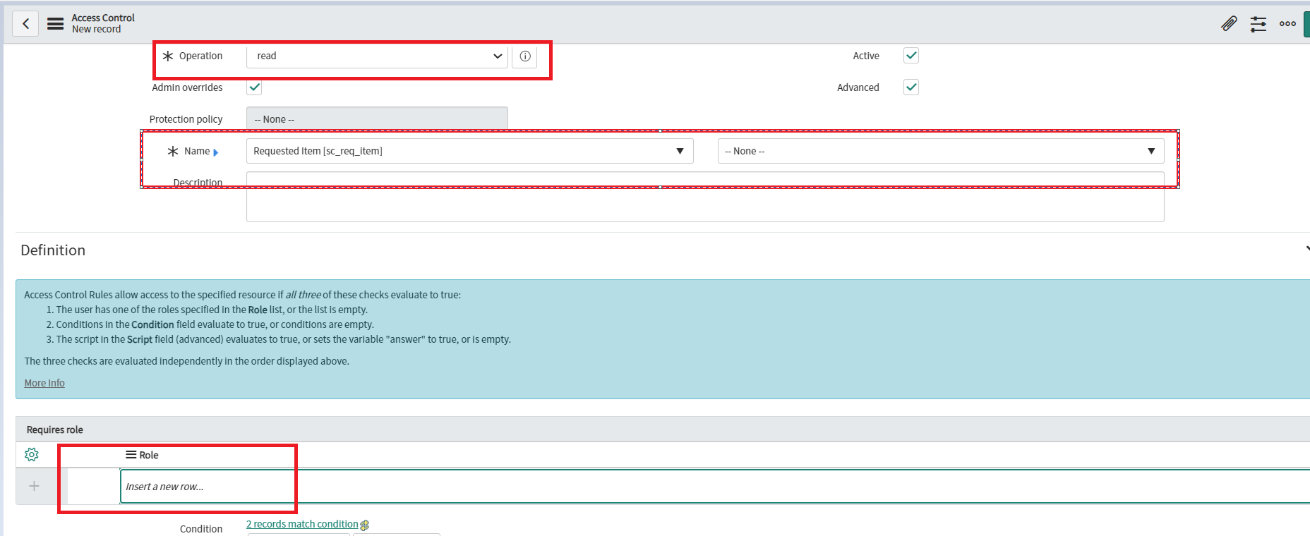

I have been asked to restrict read access to the sc_req_item table to only show records to users with the wis_api role to only see RITMs where the RITM item fullfillment group is Windows Info Services or the RITM assignment group is Windows Info Services.
I created this ACL:
but still cannot see any records when I impersonate the user with the role. Instead I get this:
Any thoughts?

Could you please tell me what type of ACL you are using here. Is it NONE or * for read operation. And please verify if there is any other acl which is written on sc_req_item table to read the records.
Please share the screenshot of your ACL fully.

Please create a table level Read Operation ACL on RITM table and use the script below:
var getRITMGroup = current.assignment_group.getDisplayValue();
var getFulGroup = current.item.fulfillment_group.getDisplayValue();
if(gs.getUser().isMemberOf(getRITMGroup) || gs.getUser().isMemberOf(getFulGroup)){
	answer = true;
}else{
	answer =false;
Shloke
Shloke
You need to validate of current Logged in USer is part of that group or not which is selected in Assignment Group or Fulfilment Group to decide if records need to be shown or not.
Also, I noticed the backend Name of Fulfillment Group is "group" so you need to modify your script shared above. Please use the version below:
var getFulGroup = current.item.group.getDisplayValue();
	answer = true;
}else{
	answer =false;
Please let me know in case you are facing an issue.
Shloke
Shloke
The user in question is not a member of the group and won't be.  The purpose of this is to restrict api access to only the records that are assigned to that group or where the group is the fulfiller group on the cat item for the RITM
