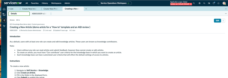

How can we get the "retire" button to be visible when viewing an article that meets requirements of being able to be selected for "retirement"?
I viewed an article in classic Knowledge and the "retire" UI action is visible.
If I view that same article in Knowledge Center, I don't see the "Retire" UI action.
Any idea how I can get "retire" visibility in Knowledge Center?

Knowledge Center : Click on edit

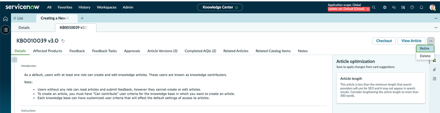

My recommendation is to not add Retire button in knowledge center and keep it as much out-of-the-box (oob) because with three clicks Edit > Then Three dots > Then Retire is already available.
So, try to educate the requestor or stakeholder and help them understand that to achieve this a decent amount of customization is required.

This is expected in Knowledge Center. The article view is a reading page, and its three-dot menu only offers Flag Article and Copy Link. Record actions such as Checkout and Retire are on the page that opens when you click Edit, and Retire is in its More Actions (three-dot) menu. That is the Edit > three dots > Retire path Dr Atul and Vishal mentioned, and it matches the docs: "When editing an article, select Retire".
