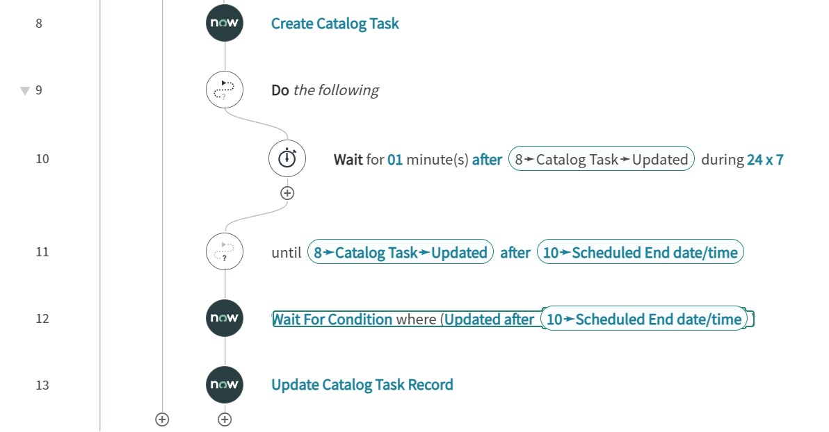

I need to autoclose a catalog task after 5 days from the last update (sys_updated_on). Can we do it by Flow Designer?
More details:-
Lets say, the task is created on 31st Jan. Now if there is no update (sys_updated_on) in that task for continue 5 days, the task will be autoclose on 5th Feb. But if there is any update within 5 days, the timer will count again for 5 days from that particular update time.
The task should be autoclose after 5 days from the last update (sys_updated_on) time.
Please note I need to use Flow Designer and not Work Flow.
This is what I designed but no luck.
(Taken 1 min duration for testing)...
01-31-2022 04:39 AM

01-31-2022 09:15 PM
HI Swagata,
Can you try this, I have made the flow to run every 1 hour. I think this is more efficient than making the flow to check for 5 non update days to close it.
Trigger - run every 1 hour
Action -
1. look up records which are updated before 120 hours
2. For all records from step 1
3. Update the state to closed complete or incomplete based on your logic.
