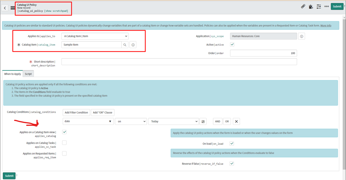

Hi @akin9 ,
You can create a catlog UI policy with a check box enabled in it as 'show in Catalog Task' , and add the conditon which matches to who the variable visible only on that particular task. Example > Description or Short_description.
ONE EXAMPLE BELOW :
i hope this helps...

Hi @akin9
You need to tick box : Applies on Catalog Task view.

We have alaready 3 ui policy are there i have checked all tick box .
but still variables not showing.
NOTE: SC task is generated by the runscript activity.
