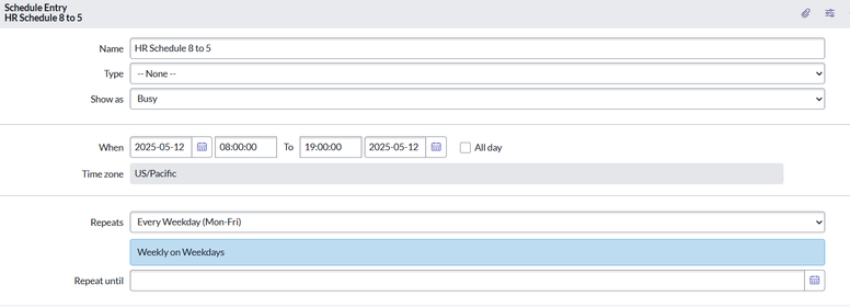

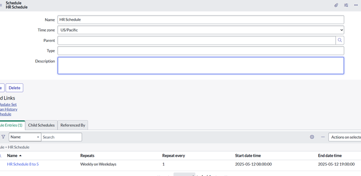

I created a schedule, inside that I created a schedule entry like below Screenshots.
Schedule:
schedule entry:
In my case schedule is from 8AM to 7pm PST MON to FRI , but consider I am in different time zone. How can I know if the schedule entry is currently running or say active?
