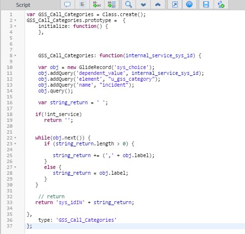

I am facing a issue with a script include I am using in for a advanced reference qualifier. The customer I am working with is using the Service Desk Call application. If they the Call type is set to incident, they should be able to choose a service, a category and a subcategory. Currently I have a reference field (Category and Subcategory) that is doing a lookup on the sys_choice table. In the script include I have added a query to get all the relevante categories and returning them, but the reference field is not populated. Pictures to follow:
Script include:
Catefory reference specification:
Category field specification:
Can anyone assist me in finding my error? Do I have to return something else than the label?

Your script might be stopping when it hits the undefined 'current' on line 11. Try passing current as another argument when you call your function.
This is how I would define the Script Include. Then call it with javascript: new GSS_Call_Categories().getRefQual(current)

It looks good... Is it working?
09-15-2016 12:33 AM
Yes, thank you so much!!
09-15-2016 02:02 AM
I do not think it should work.
string_return is collection of labels, but you are returning sys_id's with labels.
Instead of obj.label you should push obj.sys_id.
Jagarnath
09-15-2016 02:16 AM
That is true, I also had to change that.
