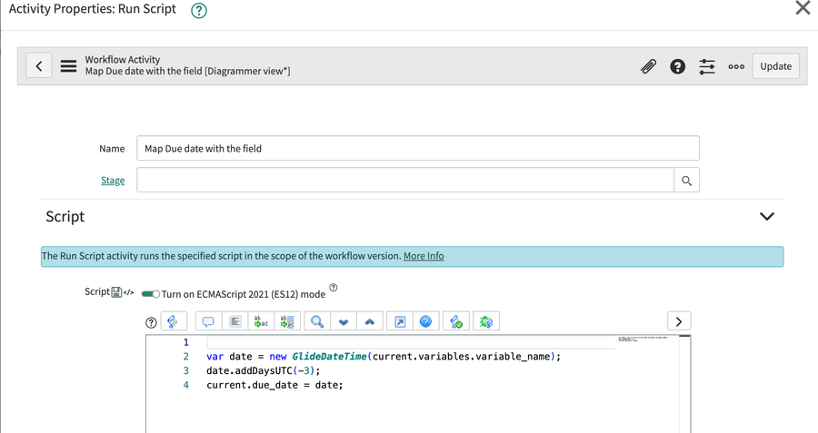

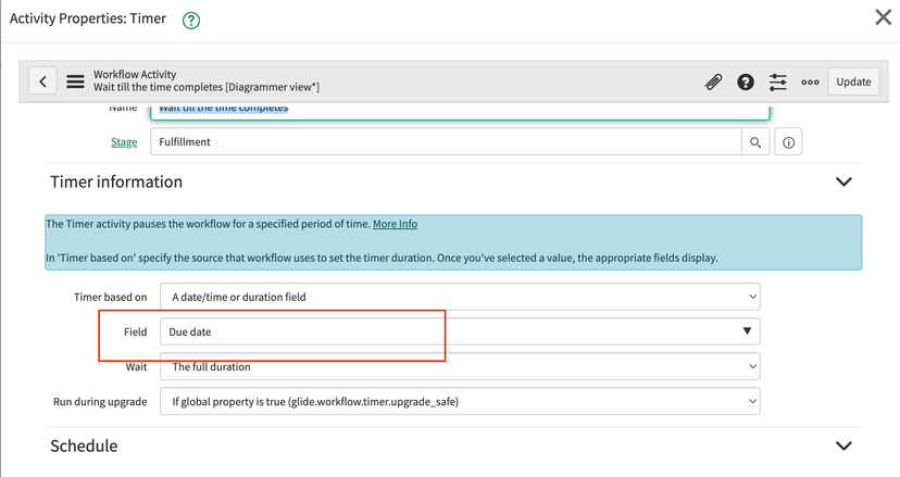

Hi @Arun_Manoj ,
There is field call due_date in RITM record, You can get the value from the from and decrease three days and assign it to due_date.
Now, wait the workflow till the due date and create sc_task.
variable_name is the backend name of the End date.
Next, use the timer to stop and select the due date field.
Next, create a Catalog task.
