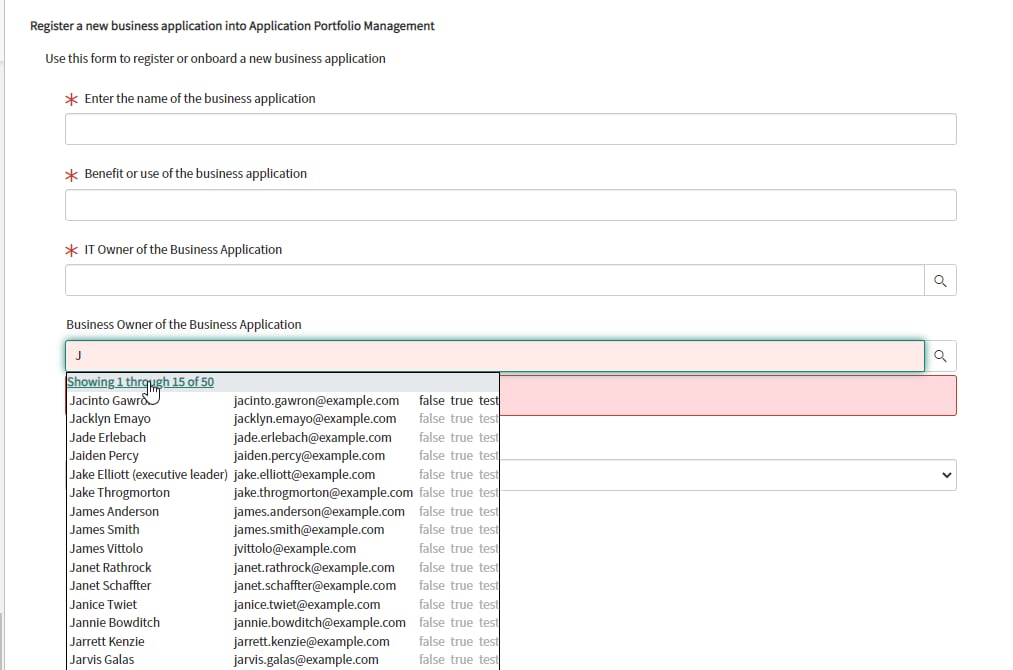

This is an OOB Catalog item
/com.glideapp.servicecatalog_cat_item_view.do?v=1&sysparm_id=125ce63ce4001410f877ce457cda6b55
that contains a variable 'Business Owner of the Business Application' that references sys_user.
A/ Add custom field to sys_user
B/ Update the sys_user collection record attribute
If I follow steps A/B (as I did in my previous post) then additional fields are visible to me in the record producer 'Business Owner of the Business Application' field.
