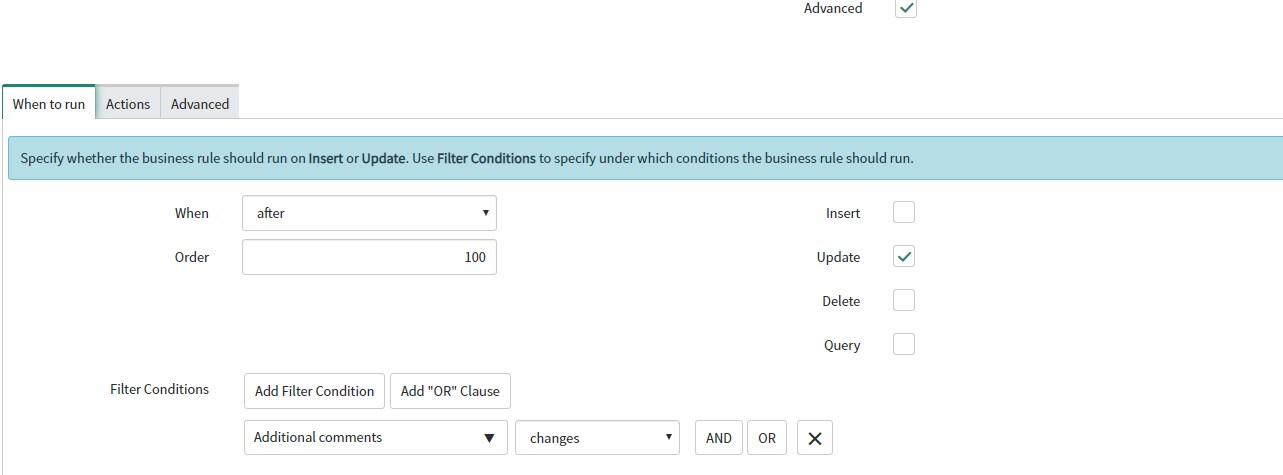

Hi Dazler,
1)You can write After Update Business Rule
2)Code
var gr = new GlideRecord("sc_req_item");
gr.get(current.request_item);
gr.comments=current.comments.getJournalEntry(1);
gr.update();
Please Mark it as Correct/Helpful if it helps you
Ankush
