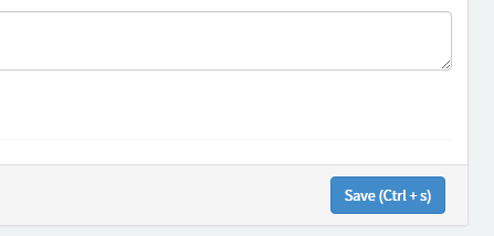

Using the out of box Record (id=form) view of any record, I would like to expose a Delete button at the bottom next to the Save button. Save is there by default, and according to the code its listed as the Primary Action on a record. However, even though a record has a delete button exposed on itself in the backend, this button does not appear on the portal.
Portal Record:
Backend Same Record:
I see that the Delete UI Action is Client side and read somewhere that Client Side UI Actions are not portal supported. This seems very limiting not to have an option to expose this or any other button (like Update and Resolve) on the portal view of the record.
How can I expose this Delete button on the portal without having a duplicate Delete button on the backend??
