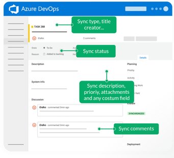

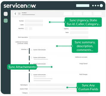

Hi Mahesh
One option you can explore is utilizing a synchronization tool like Exalate. Exalate enables bidirectional synchronization between different issue tracking systems, including ServiceNow and Azure DevOps. By configuring synchronization rules, you can ensure that relevant information and updates seamlessly flow between the two platforms.
You can also work with webhooks between these two systems, it is up to you.
