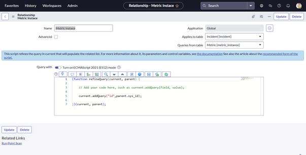

I created new metric definitions for the sc_task table. I have never created a relationship between tables before. How can I make a 1-to-many relationship between sc_task and metric_instance? Only the metrics that relate to that task and the task ID are in the metric
I want to be able to show the related metrics on a relationship tab on the bottom of the task form.

Hi @Scott29 ,
To create a related list showing all metrics related to the sc_task record you can do the following.
- Create a new Custom Relationship. System Definition->Relationships (Table Name: sys_relationship)
- Applies to -> sc_task (since you want to show related list on SC Task form)
- Query from -> Metric Table
- Use script section to build you query.
(function refineQuery(current, parent) {
// Add your code here, such as current.addQuery(field, value);
current.addQuery("id",parent.sys_id);
})(current, parent);
- Now in the SC Task from view use "configure related list" and bring you Custom Relationship in the from using slush bucket.

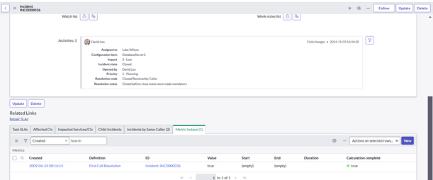

Refer an example in Incident Form:

Hi @Scott29 ,
if you have created a metric definition for SC task table
you should be able to see Metrics (just configure the related lists and add metrics)
