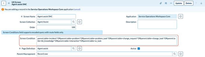

- Navigate to the UX Screen (sys_ux_screen) table records and locate the entry with the Screen Name 'Agent Assist SNC.'
- Modify the Screen Condition field by adding the table name to which you want to set up Agent Assist.

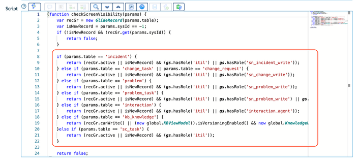

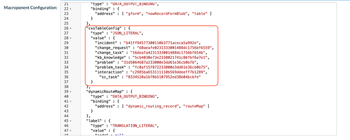

- Modify the script(refer to the image below) in the 'Macroponent Configuration' field by incorporating the table name and the SysID copied in Step 4 and Save the form.

It seems that in newer versions (maybe if your instance is in Washington or Xanadu and plugin Service Operations Workspace ITSM applications is the latest) you should be able to do this (at least I was) if you utilize different ux screen as mentioned in this article. Use the one mentioned in docs: https://docs.servicenow.com/bundle/washingtondc-it-service-management/page/product/service-operation... You will notice that screen condition is also different in this record.
Then in the UX screen conditions:
In my need the custom is to add inc task, req item as well as catalog task.
