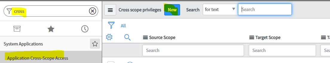

Anil Lande
you need to Give cross-Scope access to any of the API which does not have cross scope access.
Navigate to Application cross scope access:
Create New record in your application scope:
Source Scope and Application should be your custom Application.

@Anil Lande
thank you for the reply. I Already created that anil not sure what is restricting that. in the above email i pasted the screenshot which i created
