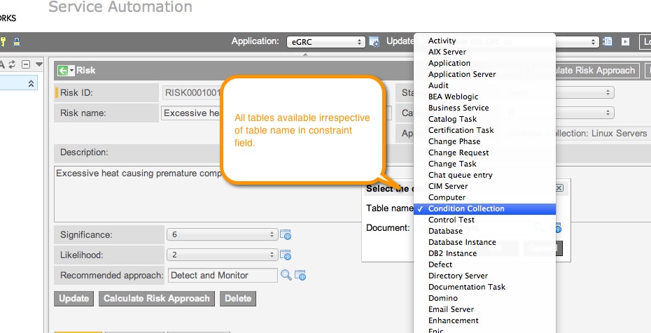

If I set u_reference_table (and save record) the document ID field u_reference will pull up a dialog box with Table name choice and document reference field, with the table name being the one I specified in u_reference_table field. HOWEVER, the table name in the dialog can be changed. Is there a way to NOT show the Table Name choice field to enforce the constraint? It seems like it's not really a constraint if the dialog box allows the user to change the table name.

It's not so much the table field (in the form that is the constraining field for document_id field type, it's the fact that doing a lookup on a document_id field brings up separate dialog box (ui page document_selector is what it looks like) and that has a table choice field in it. While I could modify that UI page, I don't feel comfortable 'owning' that ui page thereforward.

4. select lookup decoration/icon next to 'applies to' field.
5. Here, note that you get the dialog box (ui_page=document_selector) and that the table then can be changed irrespective of the dependent table set in field 'table'.

.. that while it prescribes a separate field to capture and constrain the reference to the tablename specified, that at best, all it does is pre-select that table from the dialog box but doesn't prevent the user from selecting any listed table when setting the reference.

Well, I just had a look at the code, and it *appears* that if a user can't write to the table field on which the document_id field depends, then the table picker will be read-only in that little dialog.
So I'm back to thinking my ACL idea would be the right approach. If you try it, and a correct ACL doesn't work, then I'd call that a bug.
Thanks, that did the trick. In my case i want to constrain the table to a predefined list of tables, so I created a separate read-only field which is calculated from a separate choice list (since that can't be restricted via ACL to read-only). Some security nuttiness I have to sort out as well as client script, but that does get the job done.
