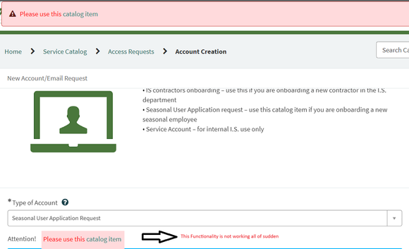

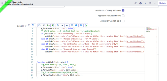

I have created a HTML variable in a catalog item. I am setting hyperlinks data to variable through client script based on a dropdown value change. It used to work as expected. When i change a value in dropdown, it shows the hyperlink in that HTML variable as in second screenshot. But suddenly it's stopped working may be from past few days. I am not sure any functionality deprecated wrt HTML variable. Attaching the code as below. Please help me on resolving this.

Hi Vrushali, Thanks for the response.
setLink is the custom function written by me for just reusability. The issue here is, url variable which i am trying to assign with g_form.setValue() is not working for html field. I still need to use setValue with your approach which is not working.

‎02-16-2024 03:10 AM
Hi Amit,
I checked the mentioned things already with adding some alerts in between. Conditions are working as expected and value is getting picked. only the setValue part is not working i believe.
