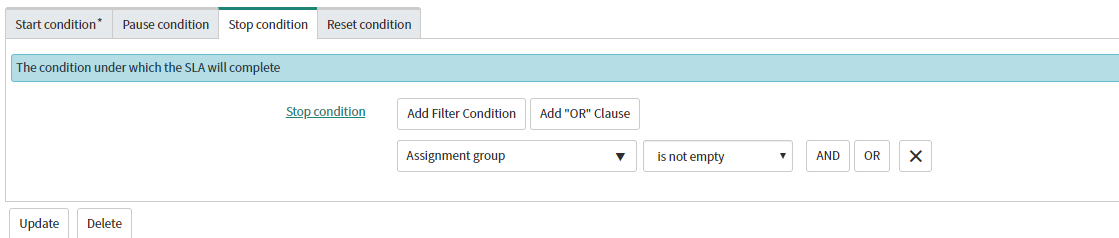

Just in case, this is the SLA definition that I created just for testing purposes:
This is the stop condition:
And this is the result of SLA definition validation. No errors on my side:

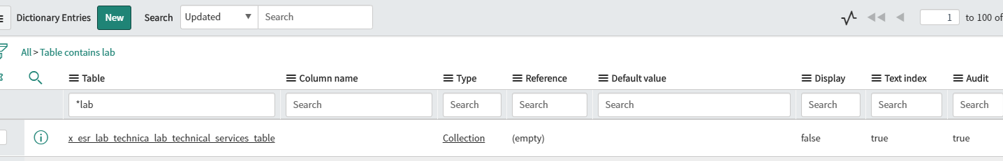

I just had to include the audit flag for the custom table and then it works for me.
Please refer to this link to see how to include the audit flag:
Regards:
Joaquín
Auditing was enabled from the get go:
