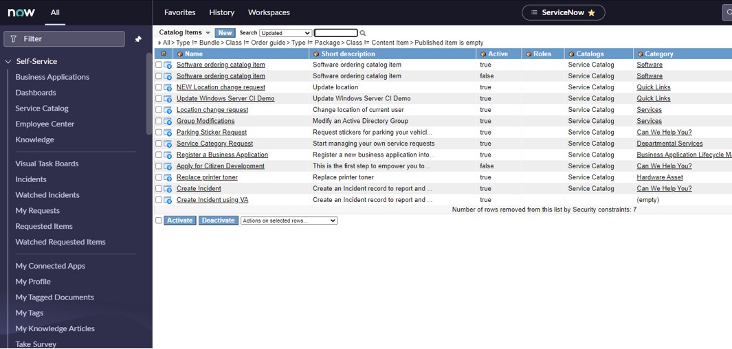

Please, I have an issue here regarding the way how SNOW is looking. It started on 3.3.2022.
First attachment: GoodPicture => How SNOW should look like.
Second attachment => How SNOW is suddenly changed...

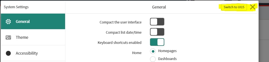

It appears your profile may be set to using UI15 which would cause this discrepancy.
The Next Experience UI (that modern purple looking theme, etc.) is from San Diego.
You may want to check your profile and see if you have UI15 selected before the transition to Next Experience UI.
This is an example of being on UI16 and switching to UI15:

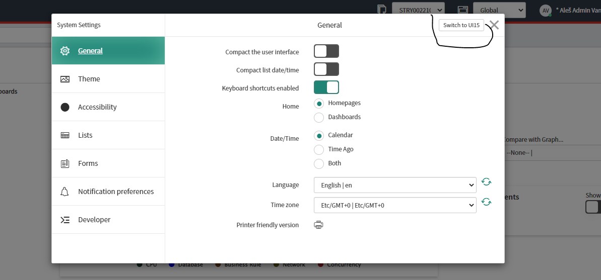

But then this happens:
Part of the view looks normal, but the pop up window is changed to UI15...
When I close the pop up window and refresh the page then it all changes to UI15, but I can see on the page in different tab that I am still on UI16...
