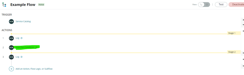

the stages of the RITM are defined and set by the flow which is selected under the tab “Process Engine” on the Catalog Item.
As I understand the flow you are trying to update the RITM from is not this specific flow but another one which is triggered based on another custom table.
In my opinion the best approach would be to handle the stages in the corresponding flow (the one selected under “Process Engine”). For instance here you can add a “Wait for” condition which will be based on your custom table or other flow. Basically, you have the two flows connected now.
