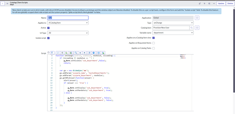

On Change Client script on Department:
replace script include name & function name
		g_form.setVisible('sub_department',false);
        return;
    var ga = new GlideAjax('YourScriptIncludeName');
    ga.addParam('sysparm_name', 'YourScriptIncludeFunctionName');
    ga.addParam('sysparm_department', newValue);
    ga.getXMLAnswer(function(answer) {
		alert(answer);
        if (answer === 'true') {
            g_form.setDisplay('sub_department', true);
            g_form.setMandatory('sub_department', true);
        } else {
            g_form.setDisplay('sub_department', false);
            g_form.setMandatory('sub_department', false);
Tested in PDI.

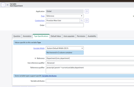

@Chirag Pathak  If you decide to change to reference type follow below steps as I there will be few changes to the script & reference qualifier
- In department variable. (parent is empty means it is itself the parent)
- In Sub department variable
Ref Qualifier: javascript:'parent='+current.variables.YourDepartmentFieldName

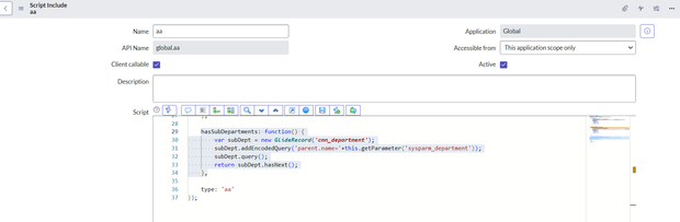

Script Include:
hasSubDepartments: function() {
        var subDept = new GlideRecord('cmn_department');
        subDept.addEncodedQuery('parent='+this.getParameter('sysparm_department'));
        subDept.query();
        return subDept.hasNext();

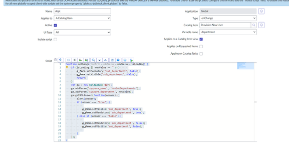

On Change Client script on department variable:
        g_form.setVisible('sub_department', false);
        return;
    var ga = new GlideAjax('YourScriptIncudeName');
    ga.addParam('sysparm_name', 'hasSubDepartments');
        alert(answer);
        if (answer === "true") {
            g_form.setVisible('sub_department', true);
        } else if (answer === "false") {
Tested in PDI. If you encounter any issue let me know
