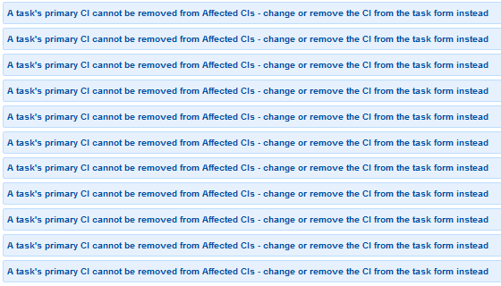

We would like to start having the Configuration Item on a Change Task sync to the Affected CI related list on the Change Request.
If a Change Request's CI was (AAA) and there was a Change Task for (BBB), we want both AAA and BBB to show up in the Affected CI related list.   The best approach appears to have a business rule that will create a new form on the Task_CI table, just having some difficulties doing it.   I took an existing Business Rule "Sync CI with Affected CIs" and made it specific for the Change Task table and made some modifications.   Below is the script and some information about the tables and fields being used.   If the form uses same Task ID as the Change Request, it should show up on the Change Request related list.   Just need help in making sure it is creating that Task_CI record.

Currently I am getting a looped error which looks like this

Michael Fry1
You can't remove it from the task_ci (Affected CI's) if the CI is in the Configuration Item on the Change form. So you probably need to check for that, and if it's not, then execute your RemovePreviousCi routing. At least that's why I'm thinking is the problem. Does your add work fine?

Hi
Did you check for any Delete BR on task_ci table? I believe you are recursively trying to remove CIs from task_ci which is causing a Delete BR to fire recursively.
I found the issue for the error and you were correct.   Started messing with an older Business Rule that I found on this site and got it working.
