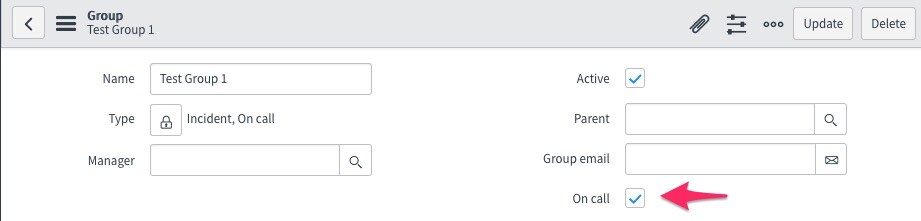

You could add a new True/False field called "On call" to the Group table and use that in your condition:
Tag all your on call groups by setting the field to "true".  Easier to maintain with a checkbox instead of changing code to make the UI Action appear or not for the groups.  Your condition could then be:
current.priority == 1 && current.assignment_group.u_on_call == true

Personally, I would go with the "Type" field as it gives you a lot of flexibility, but it might take a bit to get all your groups setup and working properly in all the different task tables.  That's why I like to do it right from the start of an implementation.  The new "On call" field, however, makes it quick to add what you need now.
