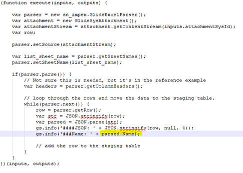

I have created a custom app.  As part of the app, I need to parse an Excel spreadsheet and create records from the data in the spreadsheet.  I chose not to use an import for various reasons, although I may be stuck doing that.
I'm using a flow that reads the spreadsheet data and creates rows in a staging table.  I'm not having trouble parsing the spreadsheet, but I am having trouble entering it into a staging table because of the headers.
The spreadsheet has column headers like "Asset", "Port", "First Found On", "Name".
I've created an action in Flow - here is the script in the action that is working:
 Because logging isn't working with my scoped app (I've opened a Support ticket), I'm unable to determine  what the JSON rows and data look like in the action by checking the execution log or script/application logs.
Using a fix script, I was able to determine I can only retrieve the value if I use the exact header - in this case "Asset" must be used and not "asset".

With a multi-word column header like "First Found On", what is the correct syntax to set the value to the corresponding field in my staging table?
var s = new GlideRecord('my_staging");
s.initialize();
s.setValue('name', parsed.Asset);
s.setValue('first_found_on', parsed.????);

@gjz In case of the properties made up of multiple words, you can try the following.
s.initialize();
s.setValue('first_found_on', parsed["First Found On"]);
Hope this helps.

gjz
@Sandeep Rajput
Thank you Sandeep, it worked.
