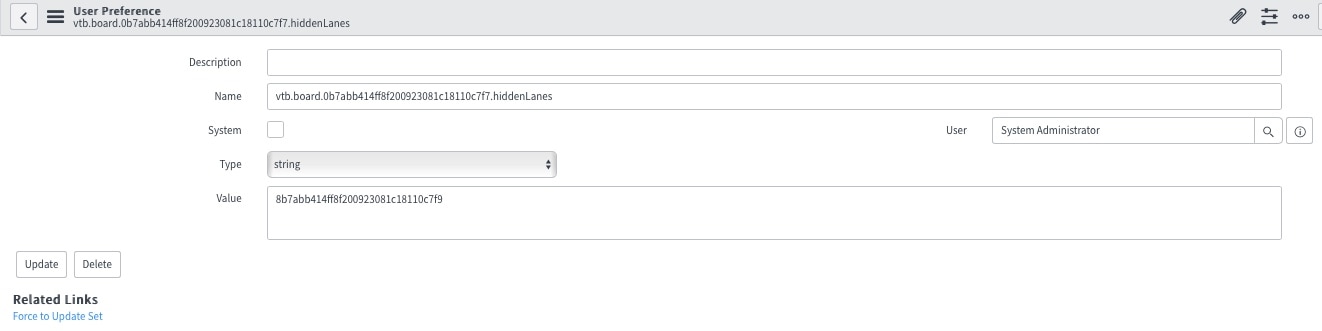

Anyway, there is no way to hide a lane via a property or so. It's possible to hide lanes, but it's then only hidden for your user. As soon as you do this, the sys_user_preference table gets a record for this, which looks like this:
The thing is, once the lane is hidden, there is no way to show it again. At least, I haven't found it, except deleting the prefence record again. Now, you could set a business rule on insert to the pref table, if the entry contains vtb.board and .hiddenLane and you're the board owner to do this:
1. get all board members from that board (via board members table)
2. copy your own pref for the hiddenLanes for all board members
This way, the lane will be hidden for all board members as soon as you as board owner hide a lane.
What do you think, would that resolve your problem?
