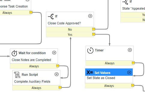

This is the workflow with the workaround. When I run the workflow without the timer, the task never gets set as inactive. The thing is that I don't want to leave the timer there, because it's a mess for the users, the page is refreshed and the values are not modified yet, I'd like to avoid that.

I am not sure, why it is skipping the BR. But you can add few logs to check, whats going on in that BR. Remove the conditions and add few gs.log or gs.print statements.
Also if that doesnt work, what if you set both State and Active flag in the workflow in the setValues box.
Hey Sanjiv,
The issue is that the state update comes after the BR, can't understand why. I'll do what you said as a workaround, setting the active state is more user friendly.
