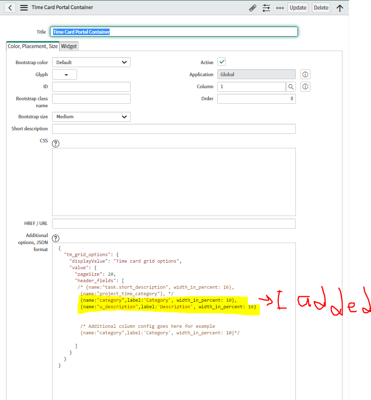

I want to change columns of list in the time sheet portal. For I want to add timecard category and timecard description instead of project time category and resource plan. How can I change these columns ?

I guess its a Service Portal Widget 'Time Card Grid', check the HTML and the Script part for the Widget. If you want to add custom columns, then you will have to clone the widget and add the same in the HTML and handle it via Server Script.

First of all, thank you for your answer. I added two columns which are Category and Description of Timecard. But I can not exclude the "Project time category" and "Resource plan" from the logged timecard list. Initially I commented the these two column script in "Additional options, JSON format" section, it did not work. Then I deleted them but again it does not work. Still the Project time category and Resource plan is visible. Can I rid of these two columns?

Did you get a chance to check this Widget Time Card Grid, in the HTML if you see these columns by any chance?
