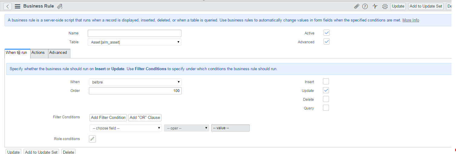

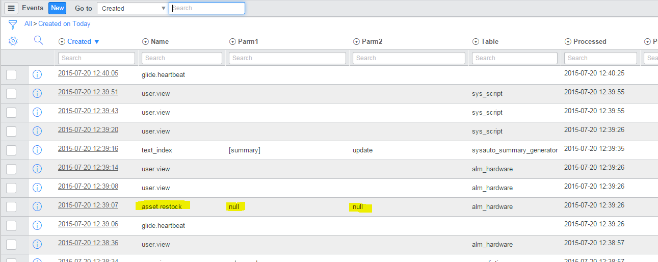

I am trying to trigger an event within a Business rule. For that, I am using the Advanced section of the business rule where I have my conditions in the condition field as 'current.substatus.changes() && current.substatus == "pending_disposal"' and then I have a function within the script block:
sendEmailOnChnageOfSubstate();
function sendEmailOnChnageOfSubstate(){
gs.eventQueue ("name_of_event", current, null, null);
And then I have a notification which fires my event and that notification has a email hard-coded within the body.
The above code is not running.
Can anyone help me modify it so that it runs fine. Appreciate your help.

Your event is registered, right?

Hi Mike,
Yes substatus is the correct field name on alm_asset table.
Yes I have my event registered.
I will try you code and see if it works.
I am not sure if I need to call my function in the condition field?
‎07-20-2015 12:27 PM
No, it would be in the script field:
‎07-20-2015 12:32 PM
I have the exact same thing its still not working
