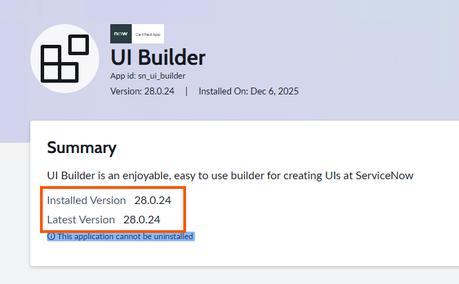

We just finished upgrading to Zurich (patch 11) from Yokohama on our on-prem lower instances.
I was looking forward to using the Components editor part of UI Builder. However, I noticed that the "Components" menu is not present when I open UI Builder.
In App Manager, UI Builder shows as being up-to-date, but version 28.0.24. On my PDI the version of UI Builder is 28.2.80.
Our on-prem UI Builder version:
If the older version of UI Builder on our on-prem instances is the likely reason for the missing Component editor, how would we update UI Builder to its actual latest release?

07-22-2026 08:51 AM
@Tanushree Maiti I added the ui_builder_admin role but it does not make any apparent difference. As I mentioned in my post, UI Builder is as up-to-date as I can get it from the App Manager. I've tried cache.do but also no change.
Could being on-prem be the reason for this apparent discrepancy between UI Builder releases?
