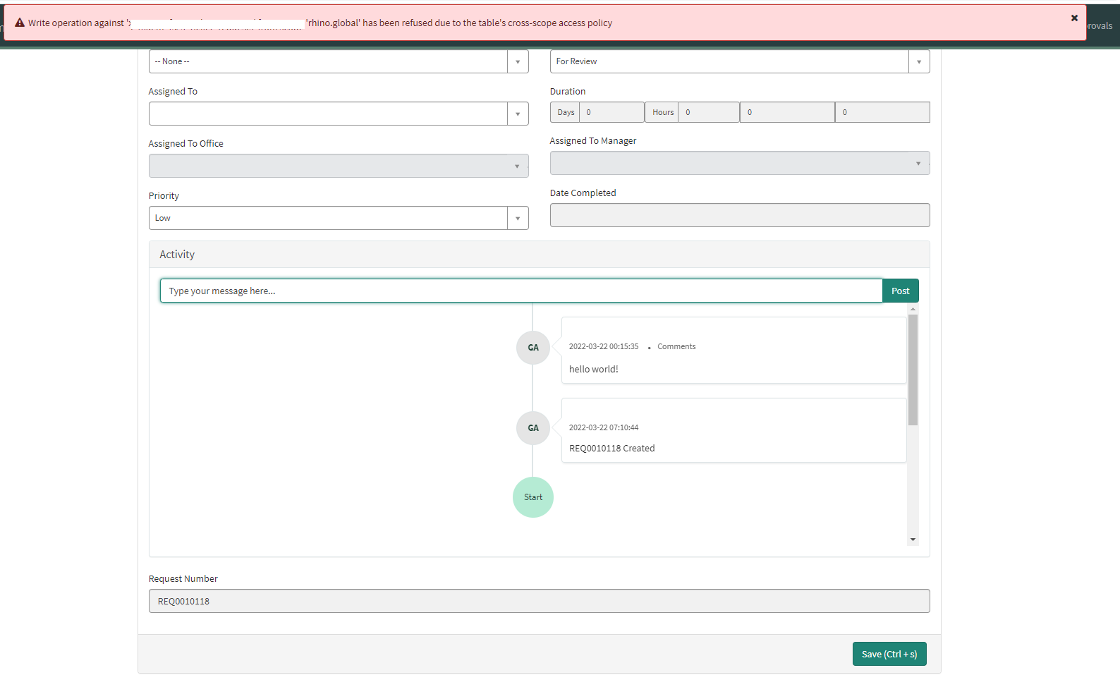

I'm experiencing this error whenever I try to add comment from Service Portal, but I can add comments without any issue from instance. I'm using Journal Input.

I solved the issue by checking the Can create and Can update in Application Access tab.
and run the following code in Scripts - Background, while using the global scope.
GlideTableManager.invalidateTable('<table_name>');
GlideCacheManager.flushTable('<table_name>');

seems cross scope issue
Did you check the table of Cross Scope privelege?
No, how do I add that scope?
