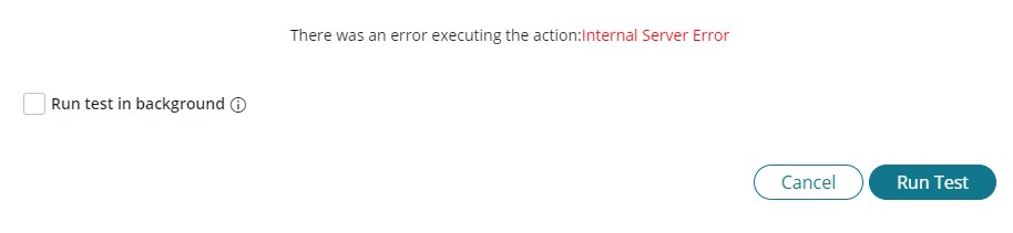

I'm trying to configure a Datastream action within flow designer.
However, when I test run the Datastream, I get an "Internal Server Error", and in the node logging I receive the following error message:
Invalid query detected, stack trace below [Unknown field element in table sys_flow_step_definition]
I have not used any scripts, the steps I went through were as follows:

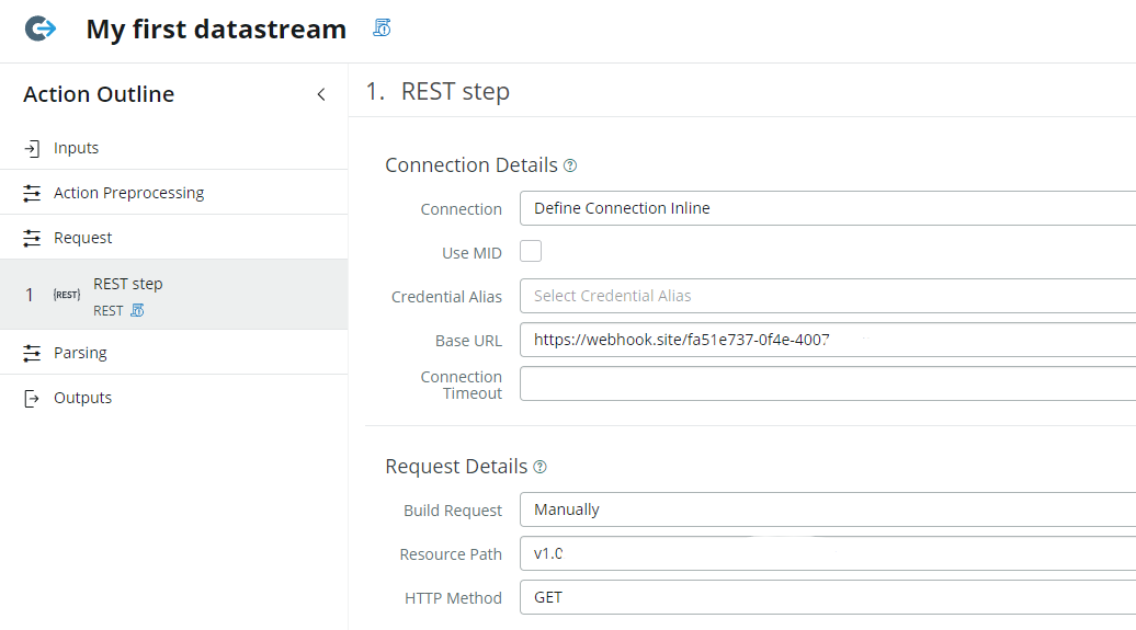

- Create the datastream
- Under "Request" answer REST Step
- Fill in the correct connection details and Request details on the Rest step
- Press Test
(SoI have not added any inputs, outputs or scripts -- When I add them, this doesn't seem to change the outcome)
