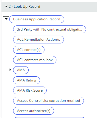

Hi @Deborah Brown L Unfortunately, that functionality doesn't work in our instance where it automatically appears.
Hi @vermaamit16  What would be the syntax for getting a field from section 2 and getting a field from within the 'Business Application Record':
