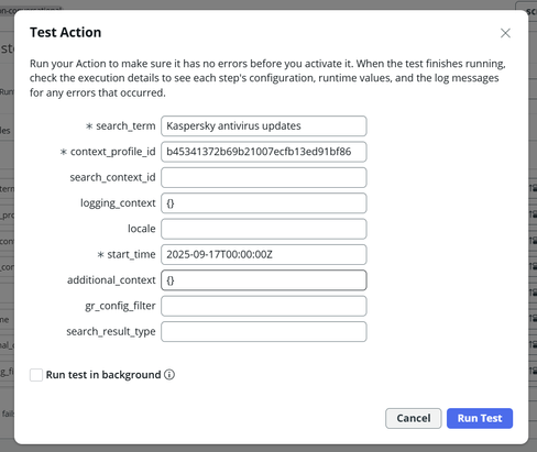

I’m using the AI Search Flow Action in Flow Designer to retrieve Knowledge Articles based on a search term. The action runs successfully and returns results, but I’m seeing a strange issue:
Problem:
Regardless of the search term, the AI Search Flow Action always returns articles only from the IT Knowledge Base, even when an identical or better-matching article exists in another KB (specifically the Customer Service KB).
If I change the Customer Service article’s Knowledge Base field to IT, then it starts appearing in the results.
If I move it back to Customer Service KB, it disappears again.
What I have already checked:

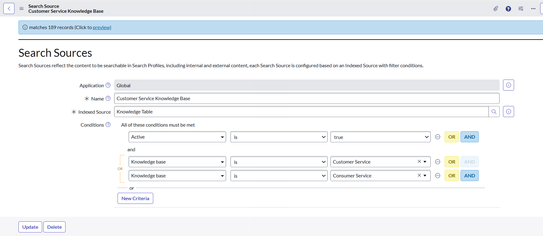

The Search Profile being used has no filters that restrict knowledge bases.
The AI Search Datasource (“Knowledge Table”) also has no KB filters, only excludes Retired/Outdated articles.
Both IT and Customer Service KBs are published, readable, and indexed (verified in AI Search Indexed Sources).
I am leaving search_context_id blank in the Flow Action inputs.
The AIS Search Source record has no filter_condition, no datasource filter, and no document table restrictions (essentially empty).
There is no Search Application associated with the Search Profile.
Permissions for the Customer Service KB are correct.
Observed Behavior:
Even with no explicit restrictions anywhere in the search configuration:
AI Search Flow Action only returns articles from IT KB
Customer Service KB articles appear only when moved to IT KB
This happens even though the Customer Service KB articles are indexed and published
Flow Action Inputs:
search_term = "Kaspersky antivirus updates"
context_profile_id = b45341372b69b21007ecfb13ed91bf86 (Search Profile sys_id)
search_context_id = "" (left empty)
additional_context = "{}"

mukesh_adh
Have you had any luck using this Action?
I keep getting an error no matter what i try to test
Error parsing additional context: JSONObject["conversation"] not found.. Request: searchTerm=travel;contextProfileSysId=ba33b44c97d56a10841eb337f053af5c;searchContextSysId=2963a5fa530020103296ddeeff7b129f;locale=;searchAttributes={additionalFilters={"geniusResultFilters":[]}, additionalContext={"logging_context":{}}};evamConfigSysId=null;callbackId=null;loggingContextString={};asyncMode=null;enabl...
