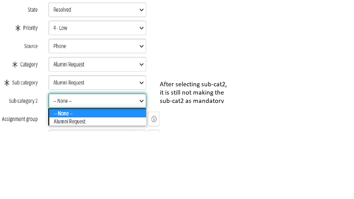

‎08-03-2022 07:37 AM
Hi Sumanth,
One more query, while resolving the case, i have not filled the sub-cat and sub-cat2. Since subcat2 length>1 or not will be identified only when sub-cat is filled. At that time it is not making it as mandatory.
1. While resolving the case with no sub-cat and sub2 selected.
2. After selecting the sub-cat, it is still not making the sub-cat2 as mandatory. and the case is getting saved with sub-cat2 filled
can you please help.
