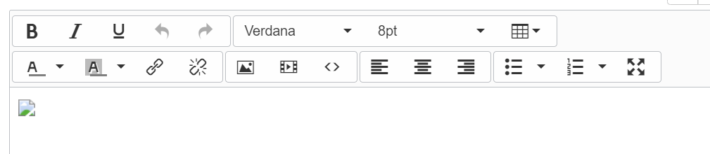

I am using a HTML field on a Record Producer on the PORTAL. The 'Video' icon is NOT available. Can I get a video input into a HTML variable field?
03-24-2022 12:44 PM
Hi Terri,
There is a known bug with the Portal TinyMCE field editor. The portal setup uses a different TinyMCE field editor than the back end. The one that the portal uses, the options are fixed, which is why the video option is missing, and you cannot add it. Attachment without the HTML field is a way o handle it, OR you can use the db_video table map to an RP. The only issue is you will have to reactive the edit/create acl on the video table.

I also got the similar requirement, for this I used Image Icon Only for Both Images/Videos upload.
03-24-2022 10:00 AM

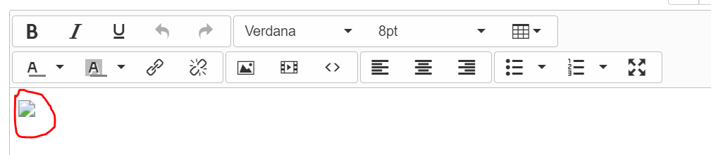

Once the Record Producer is submitted, here is what the field looks like in the background:
The 'picture' does NOT play the video. The video does however, attach to the record. If I have more than ONE video field - you cannot determine which video applies to which field.
03-24-2022 10:11 AM
Whatever we add here, they all get stored in sys_attachment table.
Just now i added one video,
Portal view:
Platform view:
Yes, You are right, we cannot determine which video applies to which field.
