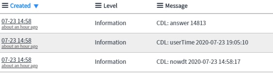

The problem is that when I run it, userTime is returning a time in GMT while nowdt is returning a time in my local EST! So instead of returning a value of approximately 400 seconds between the nowdt of 14:58:17 and the 15:05 of the userTime, it gave me what is below.
Anyone able to help me figure out how to get both into the same timezone?

This revised script will show you the correct number of seconds in your answer log - just take out the gs.nowDateTime()
//Set variables
var userTime = current.variables.when_to_send;
var nowdt = new GlideDateTime();
//gs.log("CDL: nowdt " + nowdt);
//gs.log("CDL: userTime " + userTime);
//Calculate time difference between nowdt and userTime in seconds
answer = gs.dateDiff(nowdt,userTime, true);
gs.log("CDL: answer " + answer);

try now
var userTime = new GlideDateTime(current.variables.when_to_send);
gs.log("CDL: userTime " + userTime.getDisplayValueInternal());
https://developer.servicenow.com/dev.do#!/reference/api/orlando/server/no-namespace/c_GlideDateScope...
use getDisplayValueInternal()
Looks like you and Brad did the same thing of removing the gs.nowDateTime().
