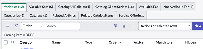

How do I add the hidden checkbox to the form for my variable? I tried different views and nada. People on the web have mentioned it should be on the question tab but I don't see it.
Brad Bowman
Mine is in the main section.  If it's already on one you might not be able to add it to another.  There could also be a policy hiding it.  If that's giving you trouble, you can also add it to the related list view and change it from there:
