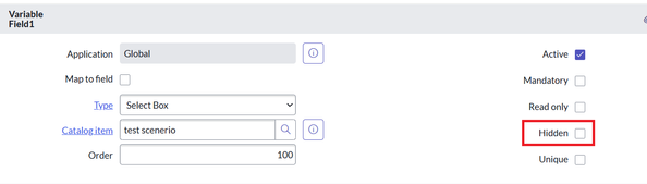

Hello @faraaz
- From the screenshot it can be seen that the variables in the variable set are not visible on form. Make sure all the variables are active true.
- Additionally in 2nd screenshot order is set to 140 whereas same variable set in 3rd screenshot has order field empty.
Please make the required changes and refresh the form page to see the changes.
