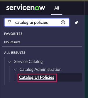

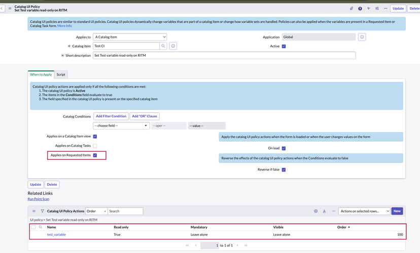

Iraj Shaikh
Hi @Basina Akash
You can set the variable read-only by creating catalog UI policy for your catalog item.
Create catalog UI Policy and catalog UI Policy action as shown below
Select your catalog item name of your variable that needs to be set read-only in 'Catalog item' field.
Select 'Applies on Requested Items' checkbox
Create UI Policy Action for your variable as shown above
