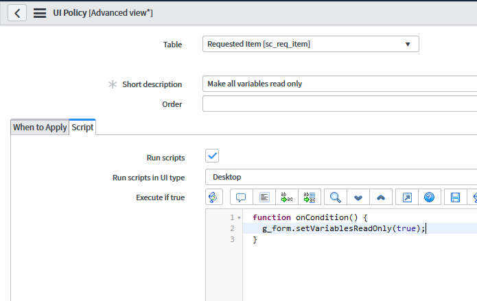

UI Policies are evaluated after the Client Scripts run.  This is probably why your script is not giving the desired result:  your onLoad() Client Script is running first, and then the UI Policies are overriding it.
You should use a scripted UI Policy for what you are trying to do.  Just create a new UI Policy and check the "Run scripts" box, then put your script in the "Execute if true" field.  See this image for an example:

I appreciate your help!
It worked.
