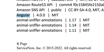

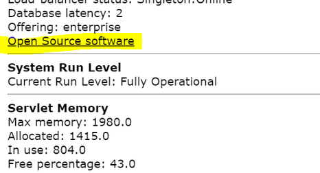

You can type stats.do in the filter navigator and then click on "open source software" hyperlink, upon clicking, a pdf will be download which contains details regarding the versions.
With the tokyo release, servicenow introduced ECMAScript2021 (ES12) version of javascript, however, it is only supported in scoped application.

After clicking "Open source software" getting this message - support.servicenow.com refused to connect.
