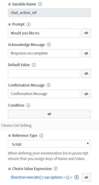

I'm populating a reference choice which is outputting the options to the end user:
Name   |    Value
End Chat       end_chat
Live Agent    live_agent
The list shows up fine, but I need to find out what the user selection is so I can use my decision tree accordingly.
You can see in my two attachments how the activity is setup.I'm logging the following:find_real_file.png
You can see I selected the "End Chat" option in the window, but it's logging the last entry when I do

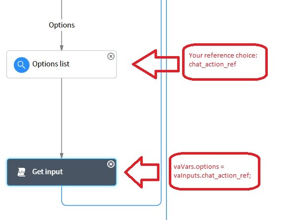

Hi huntj06,
I had a similar problem. I needed the value of user input to send it over through REST method. In my case, I get always the first value.
You need to assign the value in separate script action block and it`s better to use global value. So try to add "Script Action" right after the "Reference choice" (as showed on below screen).
Before that add script variable (in this example "options").
In "Script action" code assign user input from "Reference choice" to this variable:
vaVars.options = vaInputs.chat_action_ref; //I`m not using getValue(), it`s working without it
Correct user input should be in "vaVars.options". After that, you can use it later in the code.
I hope that will work for you too.
